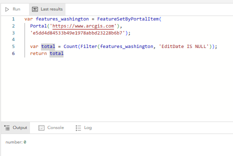

First, I need to figure out why my filter is not working. If I put EditDate IS NULL, I get the correct number of features (0):
I just can't figure out how to format to count features where EditDate is equal to 04/22/2024.

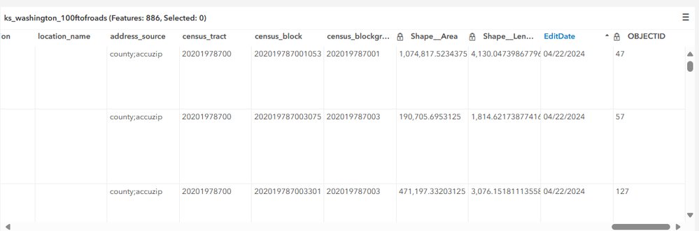

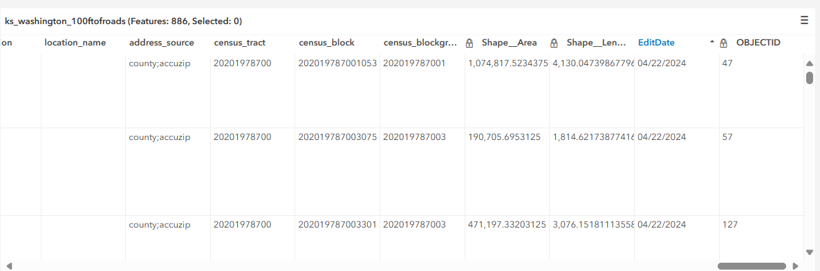

I attached a screenshot of the table with the field and attribute I'm trying to filter.
I want to count all the features where the EditDate field is equal to 04/22/2024. This field is a text type. There is no field name alias. There is no domain.

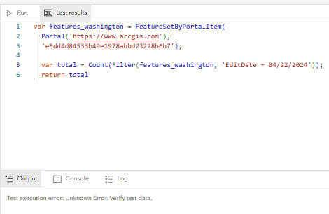

var features_washington = FeatureSetByPortalItem(
  Portal('https://www.arcgis.com'),
  'e5dd4d84533b49e1978abbd23228b6b7');
  var total = Count(Filter(features_washington, 'EditDate = 04/22/2024'));
  return total
Thank you.
marksm_macomb
I think it might just be that you're missing quotes within your SQL statement since that field is text.
In your Filter statement, try Filter(features_washington, "EditDate = '04/22/2024'")
