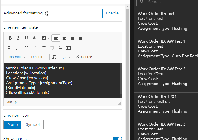

Hello All,
I am working on generating a dashboard based off a table that is updated by Survey 123. Not all fields are going to be used in each submission. I want to put together a list view that shows each submission, but I want to exclude any fields that return a null value in a specific record ({BendMaterials}, and {BlowoffMaterials} in the attached image). Can this be done in Advanced Formatting using an Arcade Expression?
Note - I don't want to fully filter out the table under the data tab of this element. There will be submissions that have null values for these two fields, but will have other important information that needs to show up on this list.

When an attribute occupies a single line of your line item template, nulls are genuinely skipped.
The trouble is that you're preceding your attributes with text, so that text will always show up. In order to get that text to be dynamic as well, it needs to be driven by an expression. You can do this with the advanced formatting.
I'll change my example to include additional text:
In general, you want an expression that returns the label and the value if there is one, but nothing if there isn't. That could look like this:
var text_A = iif(IsEmpty($datapoint['A']), '', `Field A: ${$datapoint['A']}`)
Then have your line item consist of things like {expression/text_A} instead of directly accessing the fields. But re-typing all that for each field could be annoying and tedious, especially if it's a long list of fields.
Here's a more advanced method that could apply to a list of fields as long as you want, and will handle the building of the string and pulls in the field alias.

And by entering {expression/out_str} in my list item template, I get this:
