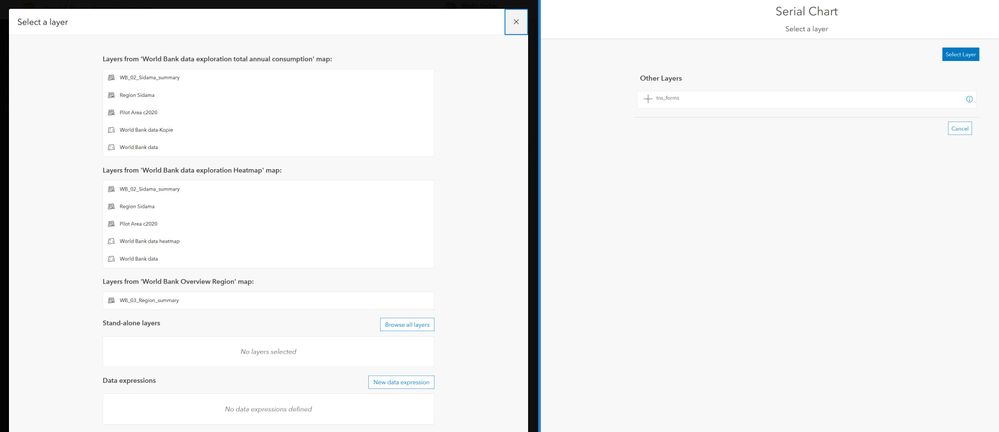

Hi,
my question is simple:
why is there no button to create data expressions in my ArcGIS Enterprise Dashboard app?
In the documentation it is described (LINK), also see the screenshot to compare.

What version of Enterprise are you on? Data Expressions are only available starting at 10.9.1.

Merlin
Yes, our enterprise version was still below 10.9.1
Cheers for the answer
