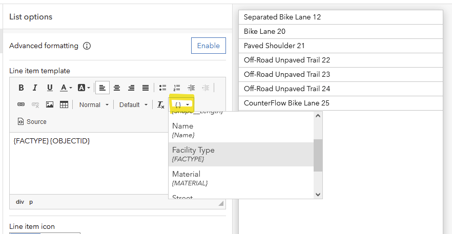

I'm able to show the domain labels in a List widget with no problems.

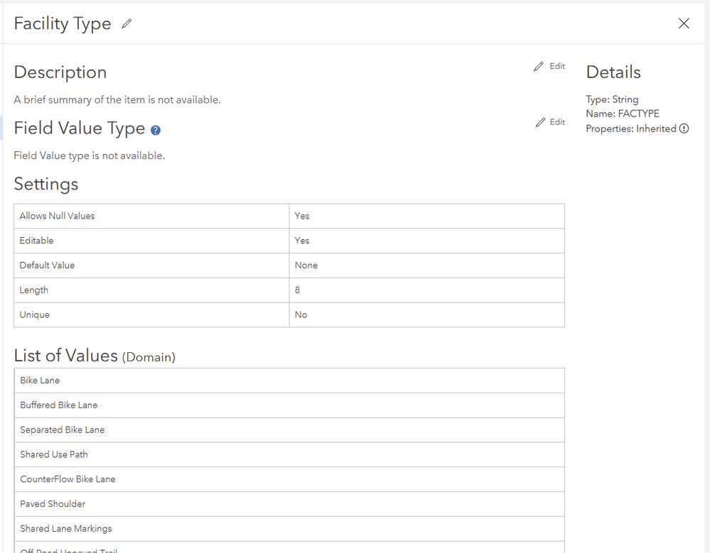

My field in AGOL looks like this -
The REST endpoint looks like this -
I added the field to the list template using the insert field button and I see the full value.

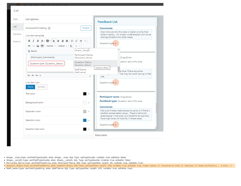

Hi Jill,
Thanks for your feedback!. I am following the exact workflow that you posted, and it is not working for me. Here is the pic! Listing the codes as text or number give me the same results. Not sure what it is going on!dash2.png
