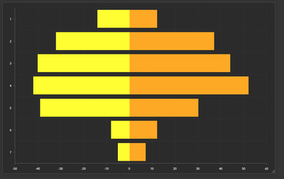

I got it working but dont know how to get rid of the negative percent at the bottom, any suggestions?

Unfortunately, that seems to be where the whole thing falls short. There does not appear to be a way to override the labels of the value axis. But then, this whole thing was sort of a hack anyway.
