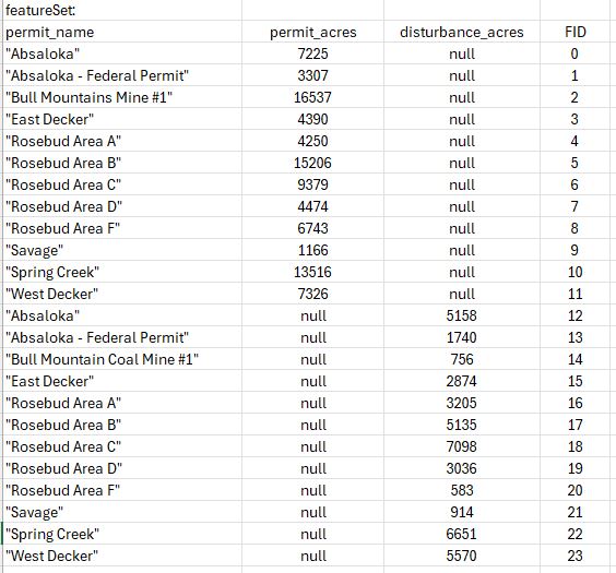

return FeatureSet(fsDict)
When i return the featureset it duplicates the area names and populates values for the second attribute, rather than just populating the records created during the first for loop. I think i need a if statement in the second for loop bur not sure of the syntax?
