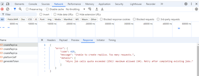

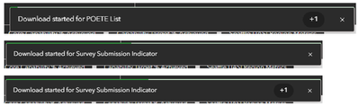

I am attempting to download data from an indicator and list widgets. It shows the download has started but fails to create a table on my machine in the download folder. Has anyone else experienced this? It started to happen a few days ago. I deleted all previous versions of the export table from my download folder.

This is the error message:
