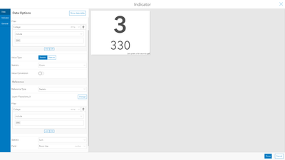

You can do this by using the Indicator widget and when configuring the widget, you can select the field from birdcount and set filter to include values with 'Y' so it will provide you the count of the records. and for the reference value you can then set as statistic and select Sum for the workhours and additionally you may set the same filter to sum only the records with 'Y'.
Please refer to the below screenshot for an example. You can modified it further to your requirements.
Hope this helps.
Cheers,
Manish
JulietK
Hi Manish,
Thank you for that, the screenshot is very helpful! Just wondering if there's any way to get the final calculated value to display? e.g. in the example, have value 0.009 displayed (3/330=0.009).
