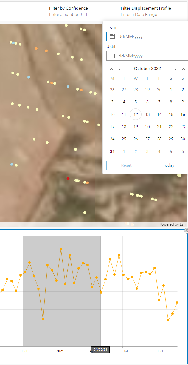

1. So I have created a data expression to calculate velocity from a portal item. The (anonymised) code is below which works perfectly fine when not date filtering. The issue occurs when I try to get the Date Selector and the multiple selection on the line serial chart to filter the dates. When filtering the date, it causes the indicator to show 'No Data'.
What can I do so that the selections filter in the data expression?
2. As the data expression is using 2 date fields (maxDate and minDate), how can I get the date range selectors so that the From date = minDate and Until date input = maxDate?
Pic of the 2 types of date selectors I'm on about.
Thanks in advance!
Ali
