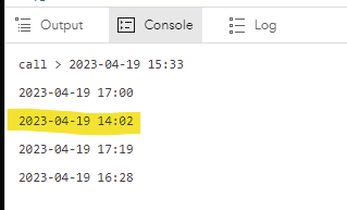

In a data expression, I'm filtering a feature layer of 911 calls to those in the last 24 hours. The filter often returns more records than I think it should

Here are the results:
I can't figure out why the call at 14:02 is not being filtered out, even though it occurs before 15:33.
Can someone point out my error here?

Even with the comparison being done on text forms of the datetime, the formatting should allow for the comparison to work as intended.  I'm wondering if timezones are a factor here and ToUTC() should be implemented.
var portal = Portal("https://arcgis.com");
var accidents = FeatureSetByPortalItem(portal, "********",1, ['*'], true)
var t1 = Text(ToUTC(Now()),'Y-MM-DD HH:mm')
var t2 = Text(DateAdd(t1, -24, 'hours'),'Y-MM-DD HH:mm')
var sql = "call > @t2"
Console("call > " + t2)
var recent_accidents = Filter(accidents, sql)
for (var s in recent_accidents) {
  Console(Text(ToUTC(s.call),'Y-MM-DD HH:mm'))

JillianStanford
That seems to have done the trick! Thank you!
