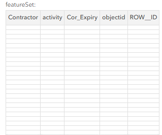

I used to get a table that showed each contractor and activity with the most recent expiry date
Now I get the following:
Ideas on why the max statistic isn't working for dates anymore?

So to fix this, I had to change my expiry date to DateOnly and convert to Text. In addition, changing the esri Field Type to string.
Once that was done, I could get the max date.
In my dashboard list, I then converted the expiry date back to a date so that I could change the colour of the results based on whether it was expired or not.
