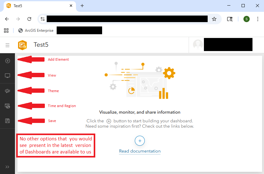

We are currently running version 11.3 while working in portal. I’ve been trying to configure a data expression in Dashboards with no luck. It turns out I believe that although we are in 11.3 our setup is still using Classic Dashboards. The number one clue is that there is no ADD DATA icon. All I see in the left pane is the following in this exact order.
  • Add element
  • View
  • Theme
  • Time and Region
  • Save
Attached you will find a basic image of a new freshly created Dashboard showing there is no ADD DATA icon (DashboardScreenshot.png). Can someone possibly tell me how we can get the new version of Dashboards added to the App Launcher (9 dots)?

CodyPatterson
MVP Regular Contributor
Hey @BillKinkaid1966
I for some reason am blanking at where I've ever seen this add data button you're mentioning. I loaded up my 11.3 Dashboard and AGOL Dashboard and the way to add data is through adding the element, and then adding the data source to the element, is that what you would want to do? What kind of data expression would you want to add?

BillKinkaid1966
I’ve been trying to run arcade through the create expression that pops up when you choose a List widget with the help of ChatGPT. I guess this is what I get for listening to ChatGPT saying there should be an add data button on the main page. It said it numerous times and was adamant about it being part of this. I know it exists in Experience Builder and took its word that it should exist in this version of Dashboards.

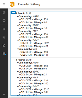

Using my test data, the code produces this list
