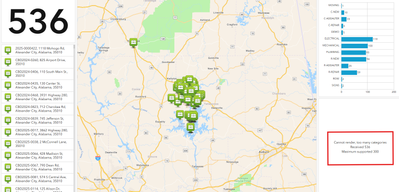

Any idea why I would be getting the Maximum supported error for a Pie Chart when I only have 13 categories.  My data is a Eurl from Cityworks.  See screenshot below.  The same data displays in the serial chart above the pie chart

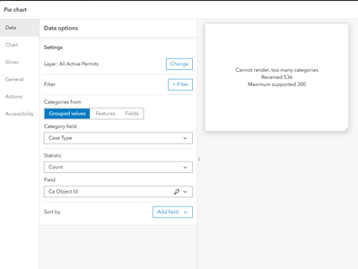

There's something definitely wrong with the grouping of the categories, I think they may not be grouped similarly as the serial chart. Check out these posts here:
https://community.esri.com/t5/arcgis-dashboards-questions/dashboard-pie-chart-data-limit-exceeded/m-...
https://community.esri.com/t5/arcgis-dashboards-questions/quot-data-limit-exceeded-quot-even-if-unde...
Could I see the setup of the pie chart? Maybe I can spot something out!

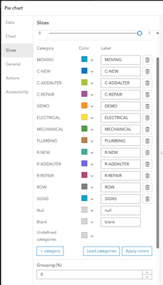

JerryWilson
@CodyPatterson
It's weird because when you look at the slices tab you only see the categories you would expect..  It's thinking that each feature is a separate category
