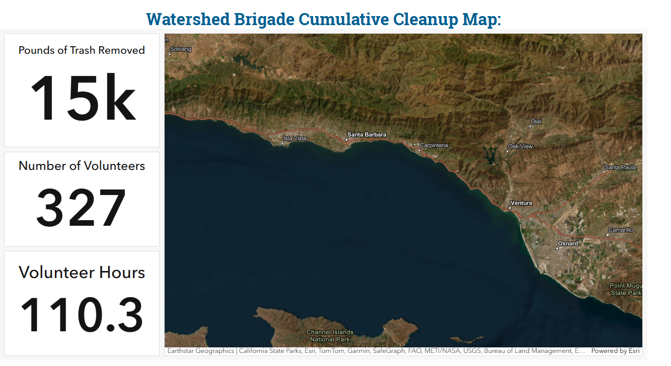

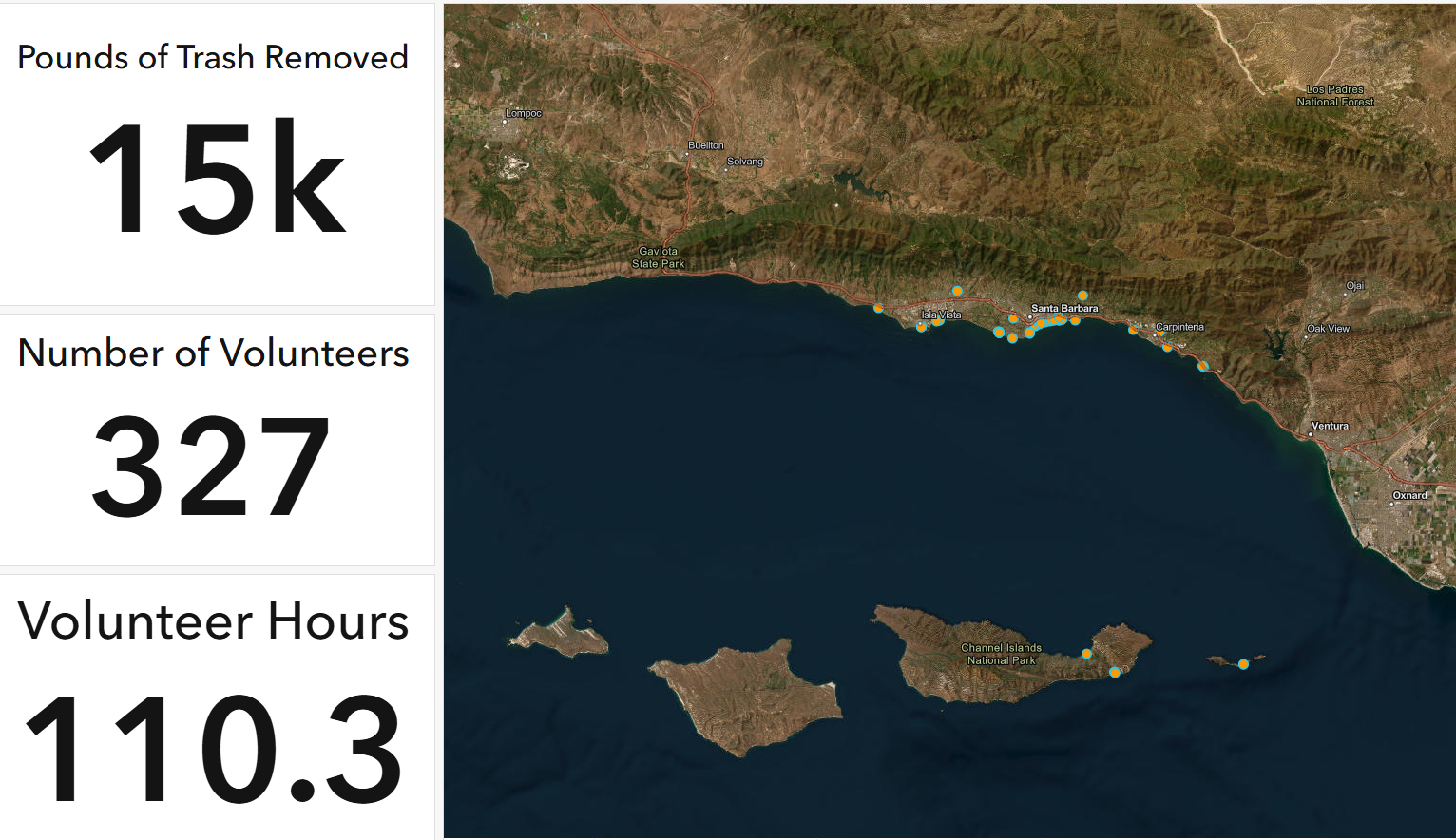

I have created a Dashboard to show data that gets pulled from Survey123. A map showing cleanup sites plus volunteer statistics. When I look at the dashboard I can see the cleanup sites on the map but when I embed the dashboard into our website the cleanup sites are no longer visible. Can anyone help me fix this issue?
Thank you!
This image shows what I see through the dashboard link

This image is what appears when I embed the dashboard in our website

Hi Veronica - Sorry to hear you are running into this problem. Is this a workflow that has been successful for you in the past with the same data/map and no longer is working?
It does sound similar to this issue posted awhile back so would be worthwhile to try those suggestions. If that doesn't fix things, a couple of other thoughts to isolate the issue, which will also be helpful info when contacting Technical Support as they will be able to help further.
- Embed just the map in your website
- Embed the dashboard in a different Esri application such as StoryMaps
