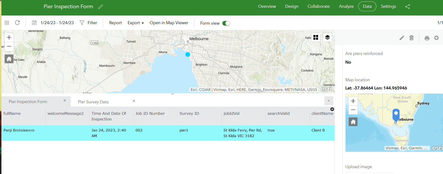

Hi everyone,
I'm having issues trying to create a webmap from the feature layers generated by Survey123. They can be seen in the Survey123 site but when I try to make a new Web Map the data cannot be loaded. I've set all the data to be public and it still cannot access the data. I've created numerous Surveys and web maps to try and troubleshoot it but it's either showing a generic error which says "There was an error" when trying to add the feature layer or it can add the layer but the points do not show up at all on the web map.
Is this something that I can fix on my end?

Below is a screenshot of the data in Survey123 which can be seen on the Survey123 app.
