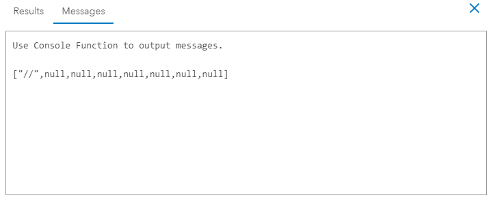

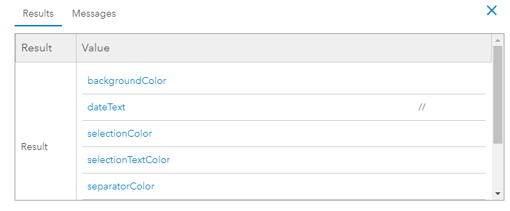

The last update timestamp is stored as a string in each feature ('YYYYMMDDHHMMSS') in a field called "LastGPSUpdate". I've written an Arcade Expression that works when I manually plug in a string, but whenever I try to reference the actual data, it returns null values. In fact, all of the "$datapoint.XYZ" globals return null values.
Any assistance would be much appreciated!
var dateInitial = $datapoint.LastGPSUpdate
var yearParse = Left(dateInitial, 4)
var monthParse = Right(Left(dateInitial, 6), 2)
var dayParse = Right(Left(dateInitial, 8), 2)
var dateParse = monthParse + '/' + dayParse + '/' + yearParse
Console(dateParse, $datapoint.BattalionArea,$datapoint.Beat,$datapoint.DispatchGroup,$datapoint.LastGPSUpdate,$datapoint.StationArea,$datapoint.Team,$datapoint.UnitType)

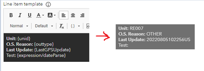

It might just be my lack of understanding of Arcade in general, but I can't get any attribute to return a non-null value in the expression. I know that the data exists -- I can display it in the Line item template just fine, but for whatever reason, everything returns a null value when I try to use it in an expression.

Are you calling it as {expression/dateText}? In your response you are using {expression/dateParse} but that is not correct going by the return statement you had above. To make things simple, I always name the attributes the same name as my variable:
dateParse: dateParse
- Jen

Whoops, that was a typo in my example, thanks for catching that.
Unfortunately, changing to call it as {expression/dateParse} did not work. It is still returning null values in the console and no data is displayed in the list.
