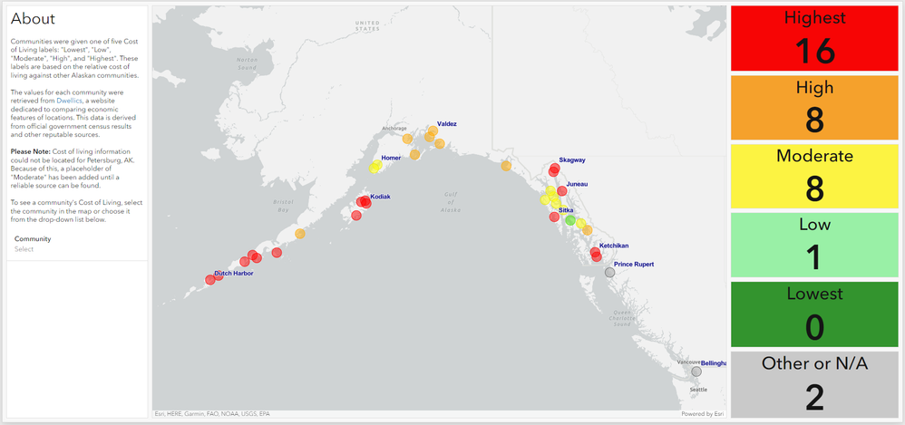

Can you elaborate on what you mean by Tile? I have a few ideas but I want to make sure I'm understanding correctly before writing out a response. In Dashboards, there are several interactive options such as pie charts, gauges, and indicators. If I'm understanding your question properly, I think a pie chart or a series of indicators + a drop-down filter would fit your needs best. Here's an example of a cost-of-living dashboard I created for the coastal communities of Alaska:
Cost of living in coastal Alaskan communities (source: Dwellics)Cost of living in coastal Alaskan communities (source: Dwellics)
Each of the colored blocks on the side are indicators that have been filtered to their respective labels and set to "count". Now, in this example I do NOT have any drop-down filters set because they are not needed. But it would be very easy to add in. Let me know if this is close to meeting your needs and we can go from there!
