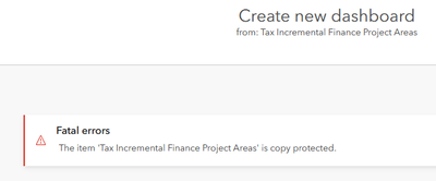

If it's a public dashboard, copying and exploring dashboards is actually encouraged!
https://community.esri.com/t5/arcgis-dashboards-blog/how-did-they-make-that-dashboard/ba-p/888765
However, the owner of the dashboard may choose to opt out of this feature.
A dedicated person could still pretty easily copy the dashboard if you're comfortable editing an item's JSON directly, but it would feel kind of sneaky if the person disabled copying.

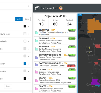

jcarlson
MVP Alum
Thanks, ArcGIS Assistant!
