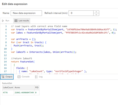

This gives me an "Unknown Error".  I've been trying some other things, but can't figure it out.
KenBuja
MVP Esteemed Contributor
I've tested the code using some of my own data and it returned the expected data. I did make a change to line 17 to use the field type "esriFieldTypeInteger" since Count returns an integer, but keeping it as it is also works.
The next step would be to put some debugging Console messages in the code at various places (like before and after line 11) and click the Run button in the editor window. This will give you a better idea where the code is crashing.
