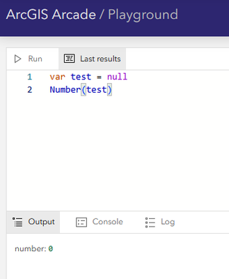

Is there a reason you're trying to convert those values to a number? The Number function returns a 0 for a null value.

@KenBuja The field is a numeric field (Double) in my layer and I want to maintain it as a numeric field so I can do calculations, but some records have missing data and I need to be able to distinguish them from values that are truly 0. Is there a better way to handle a Double field with missing values in a data expression than as a Number?

If the incoming data f isn't already a number, you can triage null values like so: Iif(IsEmpty(f), null, Number(f)).

LJackson29
@KenBuja Thanks, I thought I needed the Number() in there. I removed that per your example and getting the null values now. Thanks!
