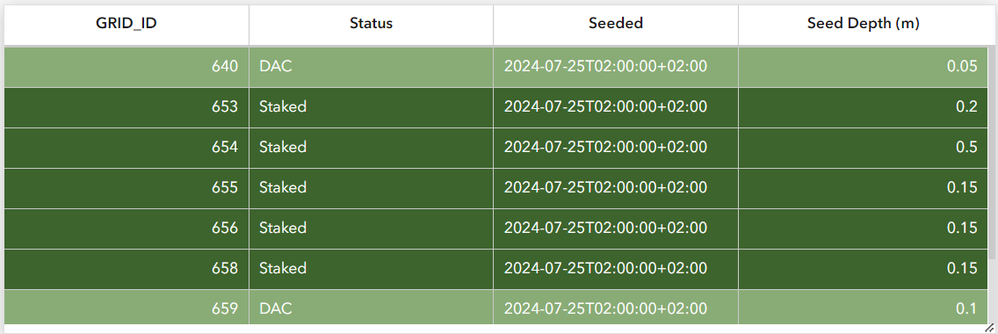

Hello.
I have a table where I would like to highlight entire rows different colors based on 3 choices from the same field.
I have one choice highlighted, but not sure how to include the other two, which would have a different highlight.  Any suggestions would be appreciated.
Here is a little snapshot of my code
// Highlight descriptions with a keyword
var keyword = 'DAC';
// Use Find() to determine the index of the word
var hasKeyword = Find(keyword, Upper($datapoint["Status"])) >= 0;
// Update text and background colors if it has the keyword
return {
  cells: {
    GridID: {
      displayText : Text($datapoint.GridID),
      textColor: IIF(hasKeyword, '#000000', ''),
      backgroundColor: IIF(hasKeyword, '#BDD7EE', ''),
      textAlign: 'center',
      iconName: '',
      iconAlign: '',
      iconColor: '',
      iconOutlineColor: ''

Hi LindsayLewin
I hope I understood your request well.
Try this Arcade code:
var highlight = ''
var colorText =''
if($datapoint.Status== 'DAC'){
  highlight = '#89ac76'
  colorText = '#ffffff'
if ($datapoint.Status == 'Staked'){
  highlight= '#3d642d'
return {
  cells: {
    GRID_ID: {
      displayText : Text($datapoint.GRID_ID),
      textColor: colorText,
      backgroundColor: highlight,
      textAlign: 'right',
      iconName: '',
      iconAlign: '',
      iconColor: '',
    Status: {
      displayText : $datapoint.Status,
      textAlign: 'left',
      iconName: '',
      iconAlign: '',
      iconColor: '',
    Seeded: {
      displayText : Text($datapoint.Seeded),
      textAlign: 'left',
      iconName: '',
      iconAlign: '',
      iconColor: '',
    seedDepth: {
      displayText : Text($datapoint.seedDepth),
      textAlign: 'right',
      iconName: '',
      iconAlign: '',
      iconColor: '',

LindsayLewin
This worked great!
Thank you!
Lindsay
