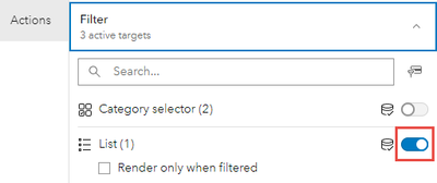

For the Category selector
Configure the category selector. Click the Selector tab and expand Settings if necessary. Scroll down a bit, under the None option section, toggle the switch button on. This will include a None button/option in the category selector.
This is what I set the parameter as, which provides two options; for the list panel to respond singularly to each of the selectors or simultaneously. For instance, to show the list based on only Category selector 1, page visitors can choose None for Category selector 2 and proceeds to select any category in Category selector 1
Click the Actions tab, expand Filter, and toggle the switch button for the list element on.

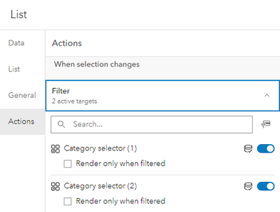

For the List element
On the Actions tab,  expand Filter and toggle the switch buttons for both category selectors on.

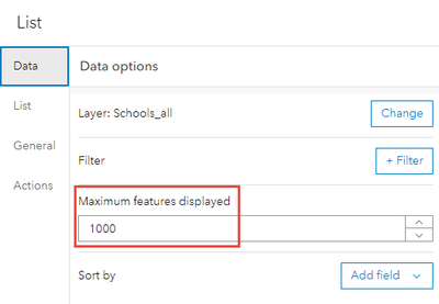

If you have big data, ensure that the value for Maximum features displayed for the list is set to maximum or larger than the whole data value.
