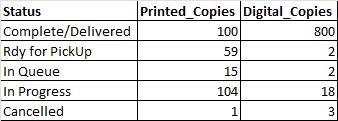

Working an operational dashboard to show working progress
I need an arcade expression for Dashboard that applies statistic SUM for fileds: Printed_Co & Digita_Co that are Rdy for PickUp or Complete/Delivered.

In the FeatureSetByPortalItem function, you have to include the "Status" field on the fields parameter when getting the FeatureSet and you were missing a closing quote for the Digital_Co field. The Filter function uses a FeatureSet as an input. You also have to put quotes around your filter expression and the "in" operator uses parentheses, not brackets.
