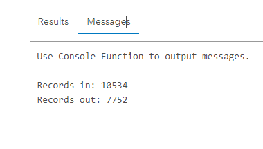

I'm having trouble with an Arcade data source that I want to use in a dashboard (Enterprise 11.1). The goal is to take some inspections in Cityworks and sort them into bins based on what year in a 5-year cycle they fall in, to help managers rebalance them.
The problem is, the expression returns fewer values than it pulls in initially. Even more perplexing, the exact number of records returned each time is different:
Here's the code I'm using (server names changed to protect the innocent). Is there something I'm missing in the code that could cause that?

It's because you set the InspectionID field in the dictionary as an esriFieldTypeOID. In testing with my data, if I use an InspectionID field that has unique values, I get the correct number of records. If I use a field without unique records, it only returns the number of unique records. Changing the field type to esriFieldTypeInteger returns all the records, regardless of whether the value are unique or not.

Ah, that worked! Thank you. Theoretically, those are all unique. But I'm happy that works. Exposed another thing I need to sort out, but this get's me very close to the finish line.
