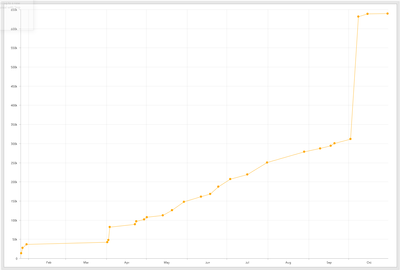

JoshHabel
Johannes,
Tried your expression above and it worked great!  See below... Really appreciate the help!!
Have a good holiday!
Josh
