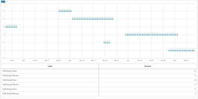

@DarrenLloyd__DOIT   I have done something kind of similar but I preprocessed the data set to prior to importing it.  For example instead of each row having a start date and a duration, I made a row for each day in the duration. So for your example it would be something like this
Traffic Study  Initial Assessment  6/6/25
Traffic Study  Initial Assessment  6/7/25
Traffic Study  Initial Assessment  6/8/25 and so on
You would then have to assign an arbitrary value to each of your "Names" to get the separation. You can do this all with a new data expression. However it still comes out pretty rough looking and, at least as far as I took it, I wasn't able get different colors for the different "names" so I had to add a table to equate the labels with the name and types. Below is  the expression, table and setup as well as the sample data set I made. Hopefully that gives you some ideas if you choose to pursue.
