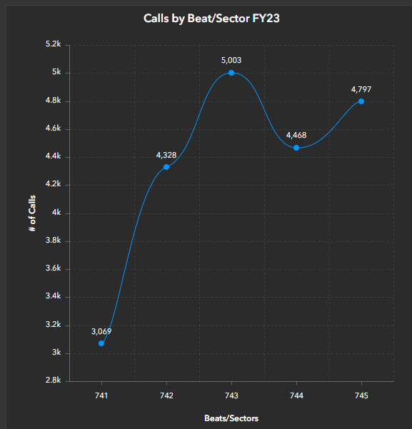

I am working on a dashboard of police call data, and I'm trying to keep the data in separate layers for each fiscal year's worth of data.  I had been doing one layer with multiple years and after 5 + years the table has over 150,000 records and it's gotten a bit unwieldy.  So right now I'm working with just two years of data.  I have a simple serial chart showing number of calls by sector in that year, but I'd like to have a chart that combines both years' calls to compare year to year.

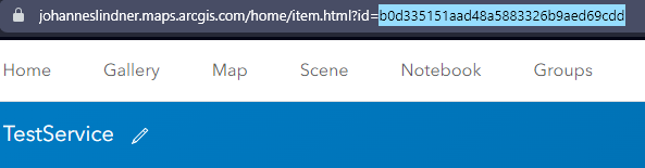

  • the item id of the feature layer or service, you can find that in the service's URL:

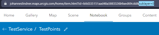

  • the layer id, which you can find in the layer's URL:
