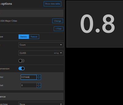

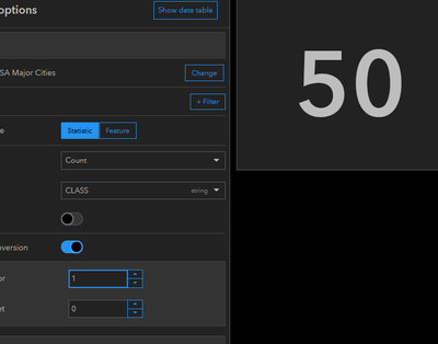

You can use the built in value conversion in an indicator.
If that 50 represented minutes, converting it to hours would be as simple as applying a factor of 1/60, or .01666, and the result is now in hours.

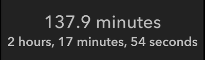

Ah, you mean like "2 hours, 26 minutes, 15 seconds". That would have to be an arcade expression. For an example, I'll use 137.9 minutes. This is using a feature-based indicator with Arcade enabled.
var dur = $datapoint['duration-field'] // 137.9 used for test
var s = (dur * 60) % 60
var m = Floor(dur) % 60
var h = (Floor(dur) - m) / 60
return {
    topText: `${dur} minutes`,
    topTextMaxSize: 'medium',
    middleText: `${h} hours, ${m} minutes, ${s} seconds`,
    middleTextMaxSize: 'large'
Which results in:
