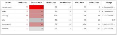

Here's one way to do it. This uses a function to return the color, which can be used in multiple columns. This shows how it can be used to change the textColor and the backgroundColor attributes.
function setColor(value) {
  When(
    value < 20, "#dedede",
    value < 30, "#C1C1C1",
    value < 60, "#D18E8E",
    "#f00000"
return {
  cells:
      //Other cells
      "First Choice":
          displayText: Text($datapoint["First Choice"]),
          textColor: setColor($datapoint["First Choice"]),
          //backgroundColor: setColor($datapoint["First Choice"]),
          textAlign: "right",
          iconName: "",
          iconAlign: "",
          iconColor: "",
          iconOutlineColor: ""
      "Second Choice":
          displayText: Text($datapoint["Second Choice"]),
          textColor: "",
          backgroundColor: setColor($datapoint["Second Choice"]),
          textAlign: "right",
          iconName: "",
          iconAlign: "",
          iconColor: "",
      // More cells

JeffHodgkiss
Thank you! I actually used the solution you posted here which gave me the following code:
var color = Decode($datapoint.STATUS, 'Normal', '#00FF00',
                                      'Yellow Alert','#FEFD41',
                                      'Red Alert','#ED1C24',
                                      'ReRoute','#F8AA00',
                                      'Trauma ByPass', '#9A3DC8',
                                      'Mini Disaster', '#7777FF',
                                      'default')
return {
  cells: {
    HOSPITAL: {
      displayText : `<span style=font-weight:bold;>${$datapoint.HOSPITAL}</span>`,
      textColor: '',
      backgroundColor: '',
      textAlign: 'left',
      iconName: '',
      iconAlign: '',
      iconColor: '',
      iconOutlineColor: ''
    STATUS: {
      displayText : `<span style=font-weight:bold;>${$datapoint.STATUS}</span>`,
      textColor: color,
      textAlign: 'left',
      iconName: '',
      iconAlign: '',
      iconColor: '',
