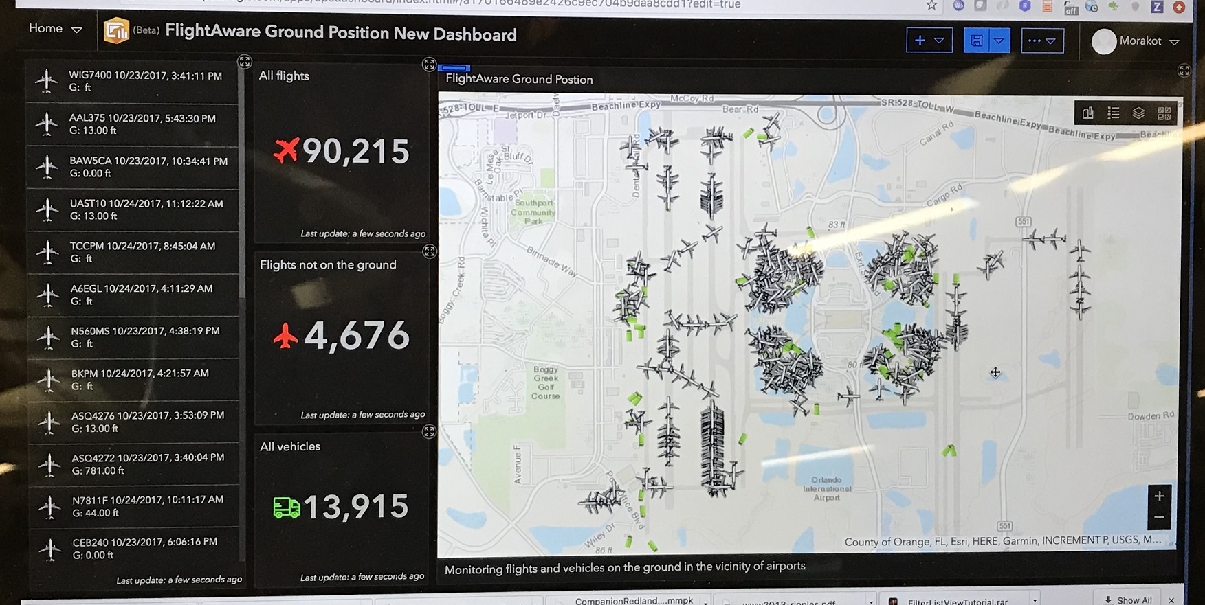

I am interested in the last image. Is that a setting to showing multiple locations for tracking purposes or is it a lag on the real time feed?
Seems like a great concept for the ATCT but it is very busy, which could cause problems.
MorakotPilouk
The data feed came from the Spatio-temporal Big Data Store. Query parameters should be set to trim down the data to be specific to what should be shown on the map. In this case the Flight number field was used and it is not unique enough because more than one Flight number can share the same aircraft. This is a reason why the map shows more flight symbols than it should be, but it is enough to get idea across. To improve this, logic on the back end data store should be used to allow query flights by the tail number which will be unique and show better result on the map.
