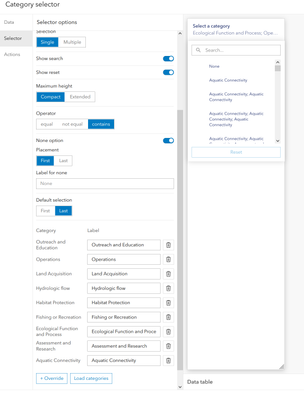

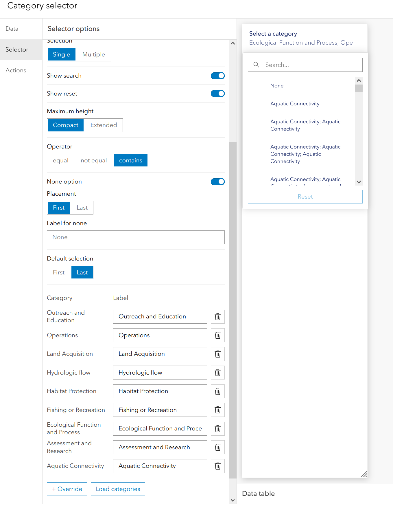

Hello,
I'm trying to use the override function to define categories in a grouped value category selector. The goal is to be able to use the new "contains" configuration to filter the map data by categories. I am able to add all of my categories, however, when I go to use the category selector, all of the possible options appear.
The filter I am trying to filter is a comma separated field of restoration project types. Since a project can have multiple subtypes (for example, aquatic connectivity, water quality, etc), the comma separated field contains all of the values.
I am able to get the new "contains" configuration to work, however, I can't get the list to appear like I want. Any thoughts on how to get the override function to work in this case @patrickb?
Tiff
Hi @KateSherman_psmfc, if you haven't resolved this yet, I just ran into this and found the fix. You want to use the "Defined Values" in the "Data" tab to define those options, rather than the "Selector" tab.
