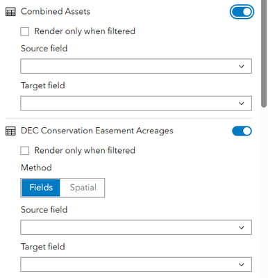

Below is an image showing a couple of options I have for applying a category selector - to this combined table (Combined Assets), where I can only filter by fields and to a table directly from something on the map (DEC Conservation Easement Acreages) where I can filter by fields and by a spatial option. I was hoping to have this spatial option available for the combined table. Is it even possible, or do I still need adjustments to my code?
As an alternate option, should I just add an attribute for my category selector as a field to my Combined Assets table (created from the code above) so that I can filter by field instead?

In this case then you wouldn't need multiple datasets but rather a single featureset to return a basic table of values to filter by. You would need to construct a basic featureset, like the example below, so that it only returns a single table of records. This will require fields to be manually specified for the new featureset table, and the attributes must map accordingly.

@KenBuja might be able to add to this in case I left something out. If you need to add a spatial component then you would simply need to pull that once. The configuration to add a spatial component has a similar structure but requires other spatial information to be returned.
