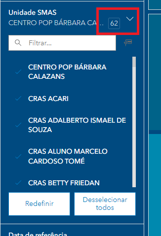

When placing the column “Unidade SMAS” in the category selector in the form of multiple selection and selecting the option “select all”, the filter returns me the 62 sectors correctly, as shown below:

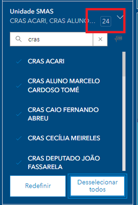

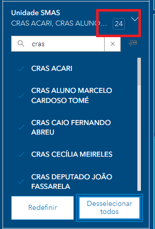

However, when filtering by “CRAS” and clicking on “select all”, the filter returns only 24 sectors (and not 47):

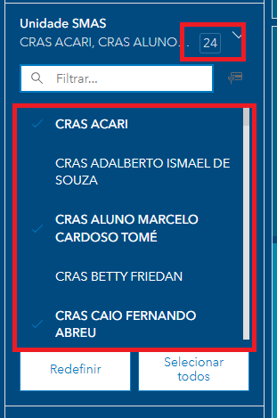

When clearing the search box, I noticed that the filter merges sectors: select one, do not select another, select one, do not select another... and so on:

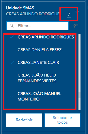

The same happens with the text “CREAS”, in which it returns 7 sectors (and not 14), again interleaving the selection:
That is: when selecting all sectors, without searching by name, the widget works correctly. However, when we type a text in the search, it does not select all the features completely, but rather merges the selection.
