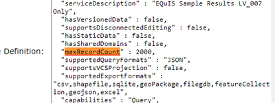

How large is the dataset that you are filtering? I'm wondering if this is due to the maximum record count returned on a hosted feature layer.

Try changing the value to 2000 using the instructions in that link to see if it returns them all.

RandyMcGregor3
Looks like it is already set to 2000. I could set it higher, but 2000 is more than the number of records in this dataset, so maybe this guy isn't the culprit?
