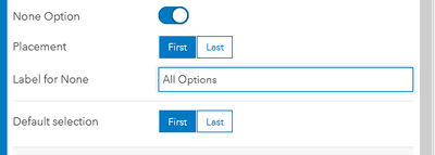

For the "All" option it's labelled in the dashboard selector settings as "None Option". Always felt a little counter-intuitive to me, but it refers to the fact that there are "no filters applied", i.e., all categories.
Just turn on the "None Option", but set the label to "All".
