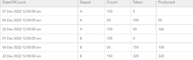

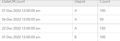

I changed your example table to reflect that the counts are not taken daily. I used the same values for depots A and B:

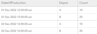

For the production, I just assumed that depot A fills 10 sandbags per day, while depot B manages to fill 20.

The "Taken" and "Produced" columns list the sandbags that were taken and produced between the current and the previous count.
