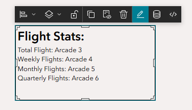

@Zelong Again not as familiar with Ex Builder, but it appears that if you want to replicate an indicator in ExB, you add a Text widget, and then can build your arcade in there.  Assuming in your feature layer, 1 row per flight, to get your count of drone flights would be something like this:
var fs =$dataSources["<datasourcdID>"].layer;
var countFlight = Count(fs)
Arcade3:
var countFlight = Count(fs);
return countFlight
Arcade4:
var currentDate = now()
var startOfYear = Date(Year(currentDate), 1, 1)
var dayOfYear = DateDiff(currentDate, startOfYear, 'days') + 1
var weekRate = countFlight/ (dayOfYear/7)
return weekRate
Arcade5:
var currentDate = Now()
var currentMonth = Month(currentDate)
var monthRate = countFlight / currentMonth
return monthRate
Arcade 6:
var currentQuarter = When(
    currentMonth <= 3, 1,
    currentMonth <= 6, 2,
    currentMonth <= 9, 3,
var quarterRate = countFlight / currentQuarter
return quarterRate
