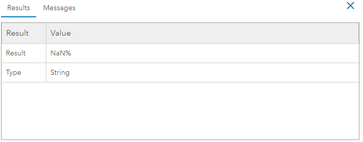

The result of the code above is shown below.
The result should be 5.98%. The field name for the population for both feature layers is Total_Pop. Any idea on how to calculate this?

Those variables todayPop and tenYearPop are just dictionaries with nothing in their features array. So for one thing, they're not FeatureSets, and for another, there's literally nothing in them to calculate values for. You need some way of either populating those and converting them to actual FeatureSets, or else you need to perform the calculation against the starYear and tenYear FeatureSets you've already brought in.
Another thing: in a dashboard data expression, you can't reference the $map, you've got to use the FeatureSetByPortalItem function to bring in any layers you're working with.
