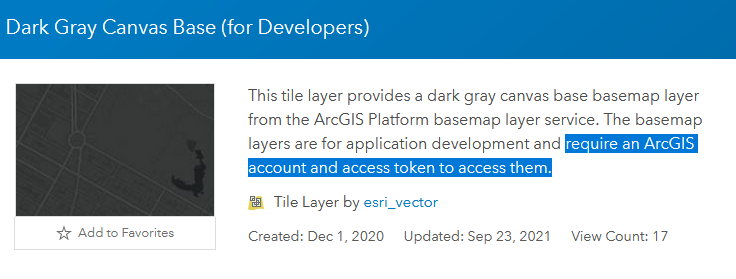

It's your basemap. Thanks for sharing your web map's ID, as that made it possible to look at its properties, where I saw this:
'baseMap': {'baseMapLayers': [{'id': 'VectorTile_2583',
    'title': 'Dark Gray Canvas Base',
    'itemId': 'f8dec62d37504266b0578ce7453b808b',
    'layerType': 'VectorTileLayer',
 If you look up that basemap layer, you'll see (text selected for emphasis):
There should be a setting somewhere to switch from the developer basemaps to the standard ones, but I don't know off hand where that setting is.

Great!! It seems that any basemap hosted by esri has this requierement. It never happend to me before.
But I solved it by adding a basemap from other source. I hope this will solve the problem really.
Thank you so much!
