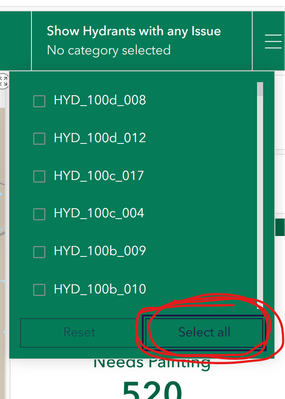

CarmenDurham
Shane,
Yes, I did submit to support.  They could not provide a solution to my request.  They gave me a workaround that provides something to our users but it definitely is not optimal.  They understood what I was trying to do but said it would not work with the data expression.
We have hydrant inspections where there are about 8 items (fields) checked in field maps.  we needed an option to quickly show the hydrants for which any of the 8 items were substandard.  And then which ones were good for all 8.
The workaround essential created this category selector where they have to choose "select all" to show the hydrant that had any sort of issue.  And tell the users to ignore the hydrants in the list and to use only the "Select all".  Not optimal but since this dashboard is only used by captains and chiefs, they can be trained.  I would never use this for a public app (see attached image)
