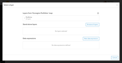

When you add an element to the dashboard, you have the choice of selecting a layer or a data expression. If it's an empty dashboard, you'll be present with this dialog

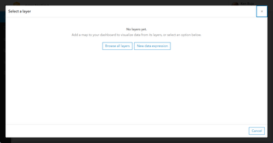

If you're using an existing dashboard, you'll see something like this dialog
In either case, click "New data expression" to add your Arcade code.
AmyRoust
Bingo! Thank you @KenBuja ! I was speeding through that step so fast that I missed it completely.
