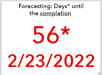

Hello,
I'm trying to use the dateadd function in order to print out a work date in the future and it's working, but returning an incorrect date. Technically it is performing properly, but I am stumped at how to account for holidays and weekends so that I'm only dealing with working dates with Arcade.
var reference = 2.34;
//var difference = $datapoint["count_ObjectID"]-reference;
//var absoluteDifference = abs(difference);
var ratio = $datapoint["count_ObjectID"]/reference;
//var ratioChange = difference/reference;
//var percentage = ratio*100;
//var percentChange = ratioChange*100
var current = Today()
var Finish = text((DateAdd(current, ratio, 'days')), 'M/D/Y')
var ratioCeil = Ceil(ratio)
return {
    //textColor:'',
    //backgroundColor:'',
    topText: ratioceil + '* ',
    topTextColor: '#e60000',
    //topTextOutlineColor: '',
    topTextMaxSize: 'x-large',
    middleText: Finish,
    middleTextColor: '#e60000',
    middleTextOutlineColor: '',
    middleTextMaxSize: 'x-large',
    //bottomText: '',
    //bottomTextColor: '',
    //bottomTextOutlineColor: '',
    //bottomTextMaxSize: 'medium',
    //iconName:'',
    //iconAlign:'left',
    //iconColor:'',
    //iconOutlineColor:'',
    //noValue:false,
    //attributes: {
      // attribute1: '',
      // attribute2: ''
The 2/23/2022 date should be 03/16/2022 if it took weekends and holidays into account as days not to be counted against the addition to the current date.

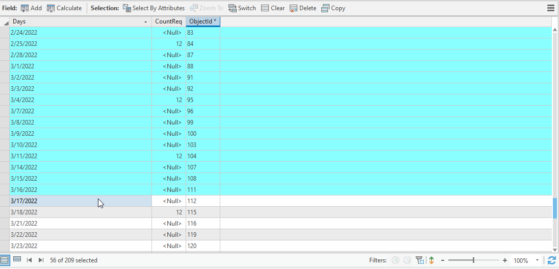

In the image below you can see the table I am referencing for some other widgets in the same dashboard to see that weekends and holidays are not included when I use this table.
I'm not sure how I could exclude the few holidays and all weekends in the DateAdd function count.
