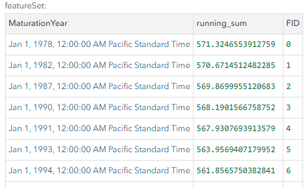

I am trying to run a cumulative sum expression on a series chart in my Dashboard using @jcarlson's excellent community post . I'm 90% of the way there, but the output accumulates in the wrong direction (i.e starts at the highest year and works backward, instead of starting at the lowest year and working foward.
If anyone has any tips to accumulate starting at the lowest year, that'd be hugely helpful!
The output:
The script:
var fs = FeatureSetByPortalItem(Portal('https://www.arcgis.com/'),'f0367a64169a4ba6bf3206c47d65147a',0,['MaturationYear','Hectares'], false);
//Count(fs);
var PYear = Filter (fs, "MaturationYear > '1977-01-01'AND Hectares > 0");
var maturity = GroupBy(PYear,'MaturationYear',{name: 'total', expression: 'Hectares', statistic: 'SUM'});
var fs_dict = {
  fields: [
    {name:'MaturationYear', type:'esriFieldTypeDate'},
    {name:'running_sum', type:'esriFieldTypeDouble'}],
  geometryType: '',
  features:[]
var i = 0
for(var s in maturity){
  var filt_date = s['MaturationYear']
  var running_sum_fs =Filter(maturity,"MaturationYear >= @filt_date")
  fs_dict.features[i] ={
    attributes: {
      'MaturationYear': Date(Text(filt_date)),
      'running_sum': Sum(running_sum_fs, 'total')
  console(filt_date)
  console(sum(running_sum_fs,'Hectares'))
  i ++
featureset(text(fs_dict))

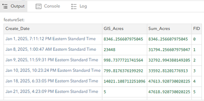

NicoleJohnson
I used the USA Current Wildfires data on Living Atlas to try this in a different way. Bear in my mind I'm no jcarlson, so this could probably be improved. I also just realized my code is lacking comments--feel free to ask questions.
Output:
Code:
var wildfires = FeatureSetByPortalItem(Portal('https://www.arcgis.com/'),'d957997ccee7408287a963600a77f61f', 1, ['CreateDate', 'GISAcres'], false);
var wildfireAcres = GroupBy(wildfires, 'CreateDate', {name: 'wildfireAcres', expression: 'GISAcres', statistic: 'SUM'});
var sumDict = {
  fields: [
    {name: 'Create_Date', type: 'esriFieldTypeDate'},
    {name: 'GIS_Acres', type: 'esriFieldTypeDouble'},
    {name: 'Sum_Acres', type: 'esriFieldTypeDouble'}
  geometryType: '',
  features: []
var firstWildfire = First(OrderBy(wildfireAcres, 'CreateDate ASC'))
for (var i in wildfireAcres){
  var thisDate = i.CreateDate
  var lastWildfires = Filter(wildfireAcres, 'CreateDate <= @thisDate')
  var cumulativeAcres
  if (i.CreateDate == firstWildfire['CreateDate']){
    cumulativeAcres = i.wildfireAcres
  } else {
    cumulativeAcres = Sum(lastWildfires, 'wildfireAcres') + i.wildfireAcres
  Push(sumDict['features'], {attributes: {Create_Date: i.CreateDate, GIS_Acres: i.wildfireAcres, Sum_Acres: cumulativeAcres}})
return featureset(text(sumDict))
