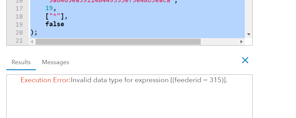

Hi, I am trying to combine the attributes from two layers hosted in the ArcGIS server with following code in Arcade Data Expression . In both layers, the fields on which the join will based is of the same data type i.e. String. The expression is returning following error.

Error Snapshot :

The field type is string, so your SQL filter expression should look for string values. You have to enclose your tableID with single quotes:
for (var p in Filter(DTS, "FEEDERID = '"+tableID+"'")){
Better yet, let Arcade handle the types:
for (var p in Filter(DTS, "FEEDERID = @tableID")){
Have a great day!

Thanks for your suggestion, now a different error is shown as below:
Execution Error:Invalid Parameter

FeatureSet() needs a json string, not a dictionary. Try this:
return FeatureSet(Text(joinedDict));
