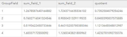

But, assuming you want to get the sums of two fields grouped by a third field, and then divide those sums for each group:
// load your data
var d = {
    geometryType:"",
    fields:[
        {name:"GroupField", type:"esriFieldTypeInteger"},
        {name:"Field1", type:"esriFieldTypeDouble"},
        {name:"Field2", type:"esriFieldTypeDouble"},
    features:[]
for(var i = 0; i < 20; i++) {
    var f = {attributes: {GroupField: Round(Random()*10, 0), Field1: Random(), Field2: Random()}}
    Push(d.features, f)
var fs = Featureset(Text(d))
//return fs
// get the sums grouped by a field
var fs_sums = GroupBy(fs, ["GroupField"], [
    {name: "sum_field_1", expression: "Field1", statistic: "SUM"},
    {name: "sum_field_2", expression: "Field2", statistic: "SUM"},
// use group by again, grouping by the same field, but using another expression
var fs_quotient = GroupBy(fs_sums, ["GroupField"], [
    {name: "sum_field_1", expression: "sum_field_1", statistic: "SUM"},
    {name: "sum_field_2", expression: "sum_field_2", statistic: "SUM"},
    {name: "quotient", expression: "sum_field_1 / sum_field_2", statistic: "SUM"},
return fs_quotient
