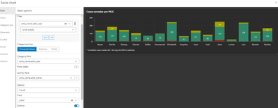

We used Workflow Manager and have 2 workflow items with the same data and properties but different timeframes. I'm not a programmer but managed to create an arcade expression that combines information from both wmx items to consolidate data in a dashboard. The problem is that although the fields used in the arcade expression are the same as using just the table from 1 item, it behave different.
I used a sublayer from a hosted view in WMX to access extended properties fields. Our serial chart considered just distinct values when setting that parameter in the dashboard.

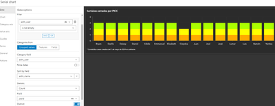

When using the arcade expression and the data combined from the same fields the chart shows equal amount of values when the distinct setting is configured.
Not setting the distinct parameter shows the correct pattern distribution but considering all records instead of just distinct values.
Why the dashboard do not show the same for both data options? What modification to the expression needs to be made to ensure the expected behavior as with accessing only 1 sublayer?
