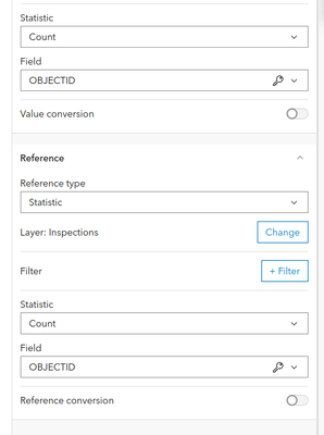

I mean, you could use code for this, but it's just subtracting one count from another? An indicator has built-in options for this, the reference value.
You can set the reference to a totally different layer, and apply filters to one or both. So your statistic could be the county of "Yes" features in Layer A, the reference could be the count of records in Layer B.
Then just put {difference} in your indicator.

Thanks but that totally does not work. I set the Parent layer (total number of sites) to be the "Layer A." I set the table holding the survey results to be "Layer B." In the indicator, I set the Top text to be {value}, the middle text to be {difference}, and the bottom text to be {reference} as you showed in your screenshots.
The Top text gives my the total number of sites.
The Middle text also just displays the total number of sites.
The Bottom text just shows how many surveys have the value of "Yes" in the "Remediation_Complete" field.
janderson_ksninc
I got it to work by switching the middle and bottom text. Thanks!
