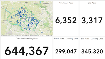

Think I got it!!
var PrelimPlans = FeatureSetByPortalItem(Portal('https://www.arcgis.com/'),'2a7c6c6f86b14253b1ecf079e3f4e6dd',1,['*'],false);
var SitePlan = FeatureSetByPortalItem(Portal('https://www.arcgis.com/'),'33c2a66277c34153907ba5d14484a24b',3,['*'],false);
//var SitePlanDUTOT = Sum(SitePlan,'APPR_DU_TOT');
//Return SitePlanDUTOT
//Distinct(SitePlan,'APNO') var combinedDict = {
  'fields': [
    { name: "APNO", type:"esriFieldTypeString" },
    { name: "APPR_DU_TOT", type: "esriFieldTypeDouble" },
    { name: "PROP_DU_SF", type: "esriFieldTypeDouble" },
    { name: "PROP_DU_MF", type: "esriFieldTypeDouble" },
    {name: "APPR_SQFT_TOT", type: "esriFieldTypeDouble" },
  geometryType: "",
  features: [],
}; var i = 0;
// Loop through each FeatureSet and store its attributes
for (var t in PrelimPlans) {
  combinedDict.features[i++] = {
    attributes: {
      APNO: t["APNO"],
      APPR_DU_TOT: t["APPR_DU_TOT"],
      PROP_DU_SF: t["PROP_DU_SF"],
      PROP_DU_MF: t["PROP_DU_MF"],
      APPR_SQFT_TOT: t["APPR_SQFT_TOT"],
} for (var m in SitePlan) {
    attributes: {
      APNO: m["APNO"],
      APPR_DU_TOT: m["APPR_DU_TOT"],
      PROP_DU_SF: m["PROP_DU_SF"],
      PROP_DU_MF: m["PROP_DU_MF"],
      APPR_SQFT_TOT: m["APPR_SQFT_TOT"],
return FeatureSet(Text(combinedDict))
