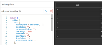

You can't do it in a List, but you could easily accomplish this in a Table widget. When you enable advanced formatting on the Values tab of the widget, one of the global variables you have access to is rowindex.
You need to add a field in the Data tab to give your row index somewhere to appear, but you can then replace both its contents and the header.
No matter how you filter or sort items in this table, the row index will always apply in the order of the visible rows.
Oh, but you may want to do $rowindex + 1 since the row index is 0-based.

This works great!  Thanks for letting me know about this option and how to get the table to work for what I needed.
