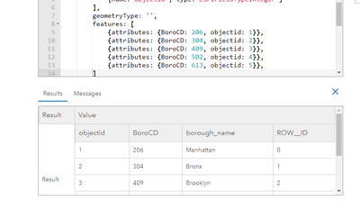

Alternate approach: Distinct. It's not really what the function is meant for, but it allows us to use SQL to generate the new field, and is usually a lot faster than a for loop, especially for something simple like this.
Try something like this:
var portal = Portal("https://www.arcgis.com")
var fs = FeatureSetByPortalItem(
    portal,
    "ea60eba0707d40a1be2f43696e2cca9f",
    0,
    ['BoroCD'],
    false // unless you *really* need the geometry, setting this to 'true' usually impacts performance more than it's worth
var sql = `CASE
WHEN BoroCD LIKE '2%' THEN 'Manhattan'
WHEN BoroCD LIKE '3%' THEN 'Bronx'
WHEN BoroCD LIKE '4%' THEN 'Brooklyn'
WHEN BoroCD LIKE '5%' THEN 'Queens'
WHEN BoroCD LIKE '6%' THEN 'Staten Island'
ELSE 'Other'
END`
return Distinct(
    fs,
        {name: 'objectid', expression: 'objectid'},
        {name: 'BoroCD', expression: 'BoroCD'},
        {name: 'borough_name', expression: sql}
  I tested this with a fake FeatureSet, and got these results:
- Josh Carlson
Kendall County GIS
anonymous55
